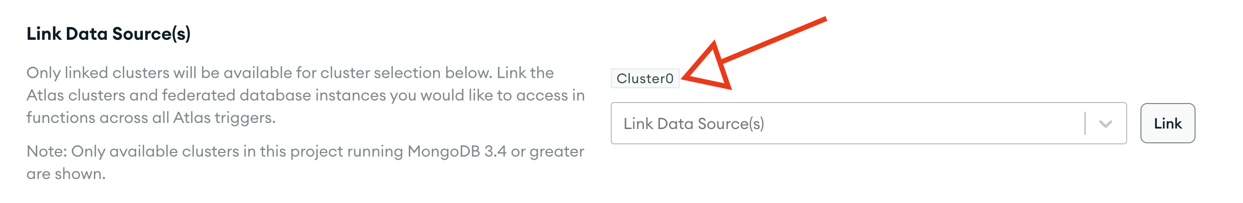

Can you go into the trigger itself and see if a data source is already linked to it? They generally appear at the top of the Link Data Source(s) dropdown menu as shown above.

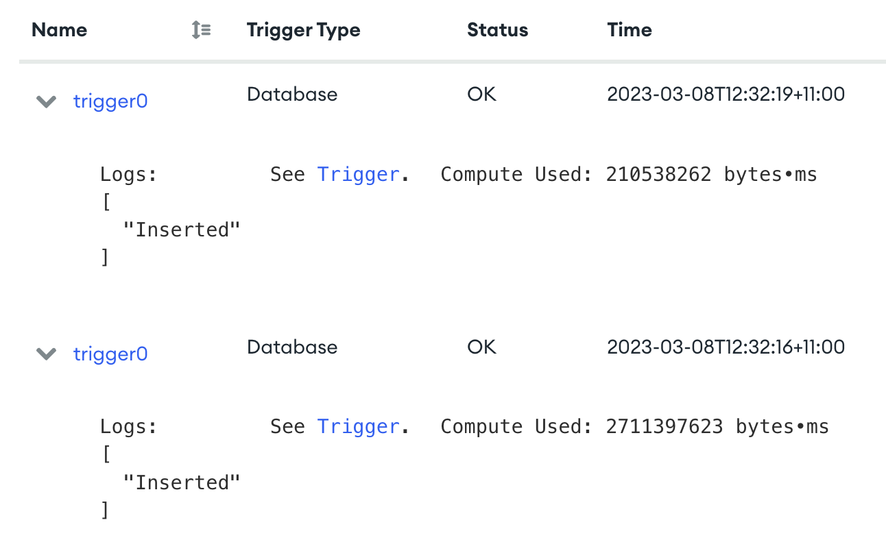

I think if you’re running it with the “Run” button as you say, no documents are being inserted so the trigger is running with no document to work against. I tested by inserting 2 documents (with the Operation Type set to "insert" for this trigger) and it recorded the following the trigger logs:
Note: I inserted a total of 2 times, 1 document each time.
This is the contents of the "test.history_col" namespace after the 2 inserts:
test> db.history_col.find()
    _id: ObjectId("6407e5a2e4f987c6ca2b010d"),
    operation: 'insert',
    'Full Document': { _id: ObjectId("6407e5a0f3015b4b893b868a"), a: 1 }
    _id: ObjectId("6407e5a3e4f987c6ca2b02a5"),
    'Full Document': {
      _id: ObjectId("6407e5a2f3015b4b893b868b"),
      a: 'this is a test string for inserting a document'

So the linked data source is actually already linked since it appears on the top already not at the link button line. Wondering why “return result;” would cause trigger not working as expected?
