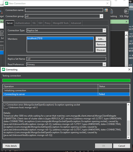

As title suggests, I am using docker-compose running 3 mongo containers. I have attached the rs.status() log and also a screenshot of Studio3t to scan my ports for the members.
I tried many variations of the connections string and ports based on the mongo documentation. I am new at this and still learning so any info helps!

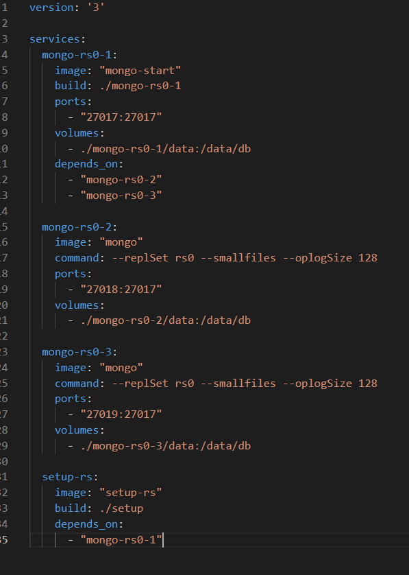

If that’s not it, could you please share your config file and your docker-compose.yml maybe so we have a bit more information to work with?

I do not believe I have done much in the network configuration. Feel free to suggest ways I can improve my docker-compose.yml file! It’s a boilerplate mongo-rs docker container I found.
And yes they are on 3 different servers.

I also see you are using --smallfiles which is a deprecated option which was only for MMapV1 which is gone now and --oplogSize 128 is definitely a terrible idea.
So ─ based on this ─ I think you are trying to deploy a development or test environment here but then I really don’t see the point of deploying 3 nodes on the same cluster. A single node replica set would most probably be good enough, no?
