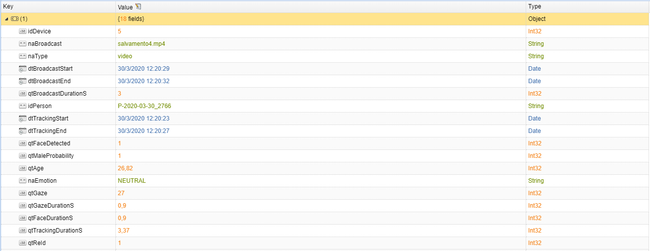

I need to cross both kind of files to determine which emissions are watched by which people, in order to estimate with a BI software if some videos have greater impact on audience than others. There are tons of emissions but only a little amount of different videos; different reactions might also come from recurrent customers (that’s why there is a PersonID).
The idea is to check overlapping between broadcasting time (that starts at data.begin and finishes at data.end) and reaction time (that starts at data.Trackings.BeginTime and finishes at data.Trackings.BeginTime + data.Trackings.TrackingDuration) in order to get a table similar to this (just a simple example for one video that provokes three different reactions; ultimate outcome would include also other parameters like Emotion, Age, etc.):
idDevice idBroadcast dtBrBeginTime dtBrEndTime idReaction dtReBeginTime dtReEndTime
1 1 2020-07-03 10:00 2020-07-03 10:03 1 2020-07-03 09:58 2020-07-03 10:02
1 1 2020-07-03 10:00 2020-07-03 10:03 2 2020-07-03 10:01 2020-07-03 10:07
1 1 2020-07-03 10:00 2020-07-03 10:03 3 2020-07-03 10:01 2020-07-03 10:02
In this simple example, 1 emission has been watched by 3 people (or has triggered 3 different reactions); i.e., 1 broadcasting file is related to 3 reaction files. How do we know this? I think the simplest way (correct me if you think there’s a better solution) is to verify these two conditions:
data.Trackings.BeginTime(ordtReBeginTime) not gtedata.end(ordtBrEndTime) -
data.Trackings.BeginTime + data.Trackings.TrackingDuration(ordtReEndTime) not
ltedata.begin(ordtBrBeginTime)
My expertise in MongoDb is limited to making very simple A-F queries ($match, $project, I also have used $unwind for breaking data.Trackings into parts), so I have almost no idea about how to address this issue… maybe with $lookup? I’d appreciate any kind of help.
