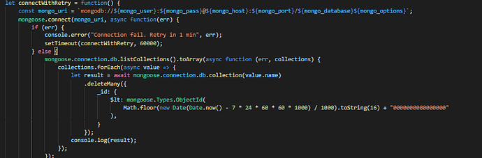

Hi @NeNaD,
Here is my code:
Still not working. They don’t find any data with this query.
If you are going to use specific knowledge about an ObjectID internal structure please use the official API.
Also take a look at TTL indexes. You might have what you want right out of the box what you need. But I think your indexed fields need to be real date data type. Another reason to migrate.
I tried the same code in my end and it works. The only difference is that I am using defined schema models for my collections.
As @steevej suggested, you should change createdAt and updatedAt fields to be of type date and not of type string.
I see… The problem is the type. But every time I format the type change to string. How can I insert date with format(“DD-MM-yyyy HH:mm.ss”) with format date?
You should not care about how the date is formatted in your stored data, it is probably some kind of number that takes less space than a string. The way it is displayed is ISO compliant. It simply needs to be the correct date type. If an ISO compliant format is not okay for you, you may display it in the format of your choice later at the presentation of your application.
