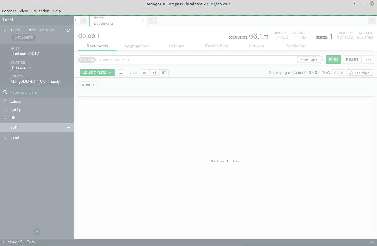

Greetings,
so i’m a long time MSSQL->MYSQL user.
I am preparing my brain and environment for migrating to mongodb.
I put a bit of stress test and now i cant figure out how to recover from that.
1.I put a script with fake name generator to fill the mounted disk with mongodb data.
2.When i woke up, it was obviously filled (5GB) with 60+ mil documents.
It was not starting,so i mounted another drive 8GB, i rsync mongodb to 8GB drive
and now its starts
3.The problem is that in mongodb compas it was showing 0 - 20 of N/A
Atleast i seen the data
4.after mongodb -repair
0 - 0 of N/A
I don’t see any data.
Please advise what is the best practice to recover from this.
Thank you

Hi @Ukro_Ukrovic,
It looks like you run the repair while the instance was running which is not how the repair works.
Why did you need to repair the dbPath if you can resync it. Resync is the best option to repair a failed node files…
Compass cannot calculate all data so its better to use a shell connection and run a count on the documents and se that the value is the expected one. Additionally you can run a validate command on the collection to verify its integrity…
Best regards,
Pavel

Hi @Ukro_Ukrovic,
The log line looks good so I expect data is consistent.
You can use a shell connection from Compass when clicking the bar on the lower side.
Additionally, you can just count all documents with aggregation tab:
Best regards,
Pavel

The header says it has 66M documents .
The UI seems to not load yet so I am not sure the “No Rows” should be taken seriously when the query still running.

So you are thinking that the compas gui gave up after some timeout?
Ok so i figured it out.
The problem was between chair and keyboard.
When i was testing find, after that i removed it from textbox, but didn’t press find to clear the memory i guess.
So whenever i press refresh it was refreshing from the saved memory even if textbox has empty string.
When i pressed find and then refresh, all see ok
Still with
1 - 20 of N/A
But its fine, atleast i see all stuff.
Thank you for your time.
