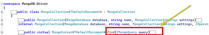

i see there …Find will accept only ImongoQuery…

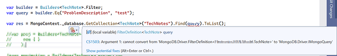

Hi ,
this is the error , it is not accepting as query…
I have 2 suspicions about the problem: Your class definition has a problem, or somehow you are using a different namespace for one of your variables. Can you please check them first?

  • this following code which your screen shot refers exists only in Legacy driver code:
    • public virtual MongoCursor<TDefaultDocument> Find(IMongoQuery query)
  • You are clearly state that Query works (which exists in Legacy code), Builders does not (which is in versions >=2.0).

The problem is caused by the way you access the database. This is the modern way:
var database = dbClient.GetDatabase("testme");
And the following is the legacy code to do the same:
var databaseL = dbClient.GetServer().GetDatabase("testme");
A very simple, easy to miss, extra code to remove: GetServer().
Keep an eye out for similar code fragments in your journey ahead.
