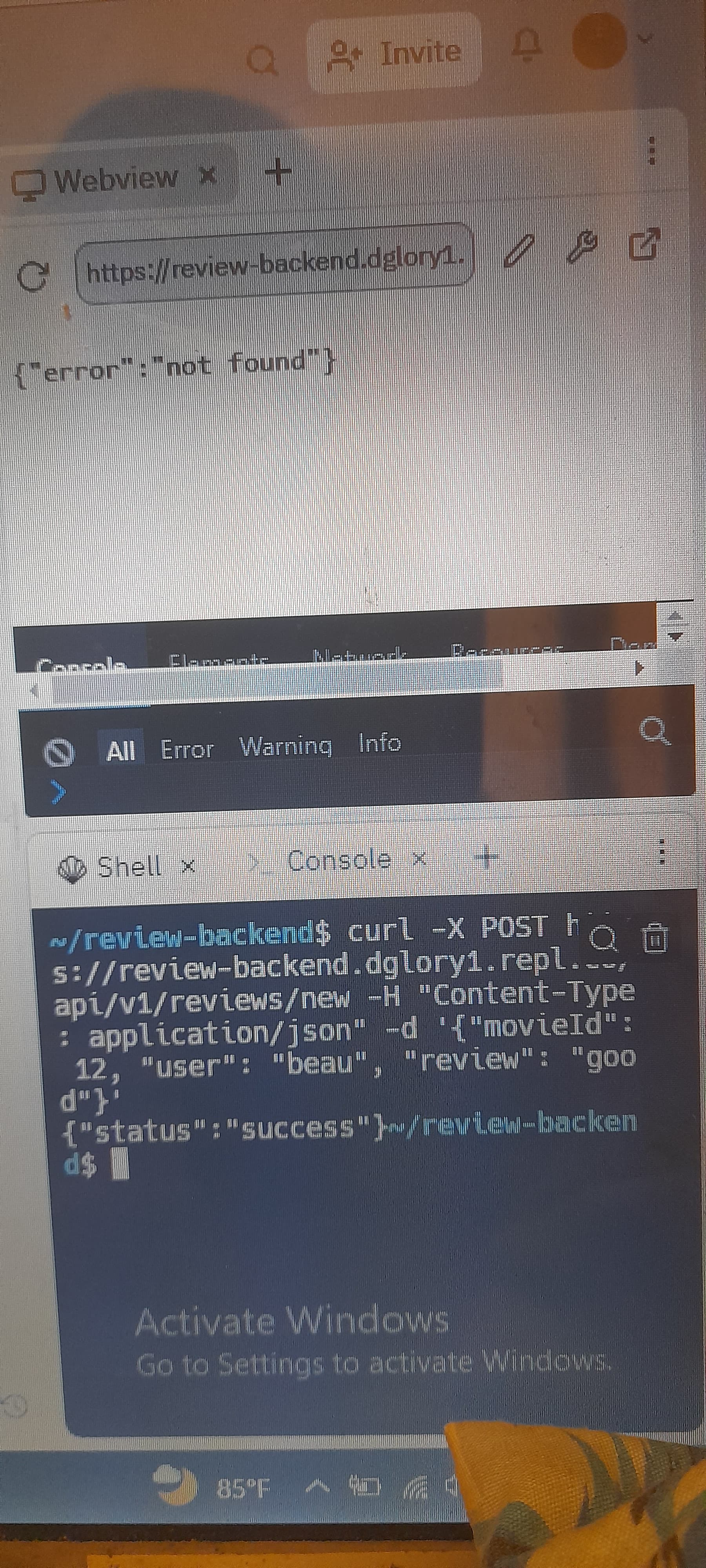

Pls I am having issues creating my database in mongodb,I am using replit IDE, no errors in my “console”, “Shell”, my codes are working fine, it said succes when I tried using curl link to create my database in “Shell” so I dont know what is wrong I tried using schema code for linking stuff didn’t work even mongodb compass, isnt working tried configuring open ssh server to see if the issue would be resolved still didn’t work, I have tried soo many things that I am speechless self on what to do

from the looks, I would say you have not provided a movie id in your url. when you used “curl” you have inserted a movie with an id of 12. so your url should end with “…/api/v1/reviews/movie/12” to get reviews for the movie.
there are few issues with it:
an new empty database return nothing, and you get “not found”.
you need to first add a review with movie id.
you get “not found” if you don’t give an id in the url, either for movie or review.
more importantly, that repl has a couple of design issues on defining endpoints. for example, it loads all reviews at the beginning without a filter, so take it as an example only.

this endpoint is reading all reviews for a given movie with an id.
check the “server.js” file. app.use("/api/v1/reviews", reviews) tells you that to operate on reviews your url must have this form .../api/v1/reviews/.... then in “api/reviews.route.js” file you see the rest of the endpoints to append to this url:
.../api/v1/reviews/movie/12 + GET method is to get all reviews for movie of id 12 (12 is just an example)
.../api/v1/reviews/new + POST method is to create a new review
.../api/v1/reviews/123abc + GET/PUT/DELETE methods are to read/update/delete the review with id of 123abc. this id is just an example. an actual mongodb id corresponds to a 12 or 24 character string.
so your frontend must communicate with this backend server through these endpoints. check “api/reviews.controller.js” to see how requests are processed. when using POST you need to send an object in the request body similar to the one you used with curl in your first screenshot (req.body.movieId, req.body.user, req.body.review). GET and delete needs only an id in the url (req.params.id). PUT needs both an id in the url and object in the body.
by the way, this server is open to public as you can see, and anyone can read/write/delete on these endpoints right now. so when you finish learning basics, you may want to learn security basics after.

except design flaws, there is nothing wrong with both repls I linked. the problem is your expectation it seems.
these repls are coded only to create a review with a movie id, get reviews for that movie, and 3 more operations on a single review, that is all. you cannot do anything else. you need to crawl the source code, learn how endpoints work, adapt/expand the source so you can do more.

You did not answer that part, but you do not seem so. I am guessing you were using someone else’s repl all these times because your first screenshot shows the successful creation of a review. you cannot create something on your database using a url that does not belong to you.
