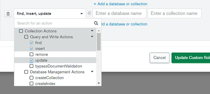

These are the permission I gave in the custom role
In the db i put myDbName and in the collection I inserted 3 to test it out, pressed save, waited 1min then connect using MongoDB Compass and nothing showed.

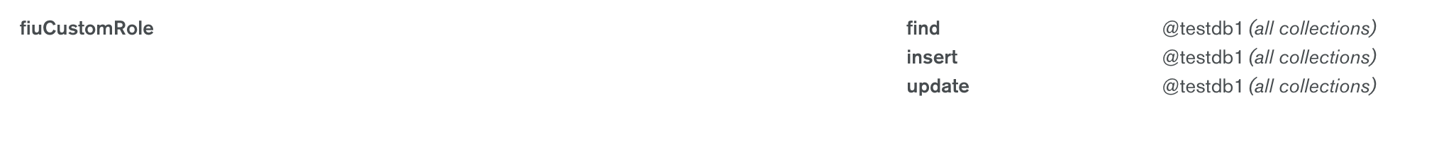

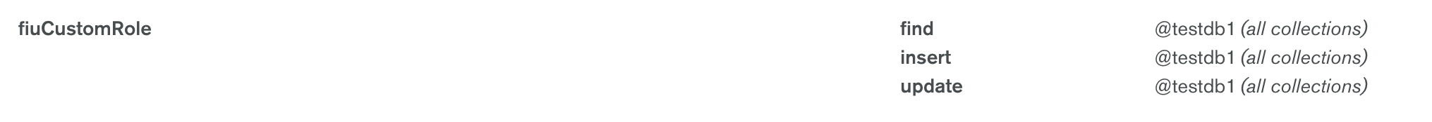

  1. Created the custom role fiuCustomRole with find,insert and update permissions on a database named testdb1:

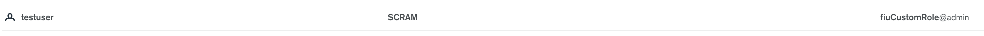

  2. Assigned the custom role fiuCustomRole to the Database User testuser:

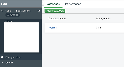

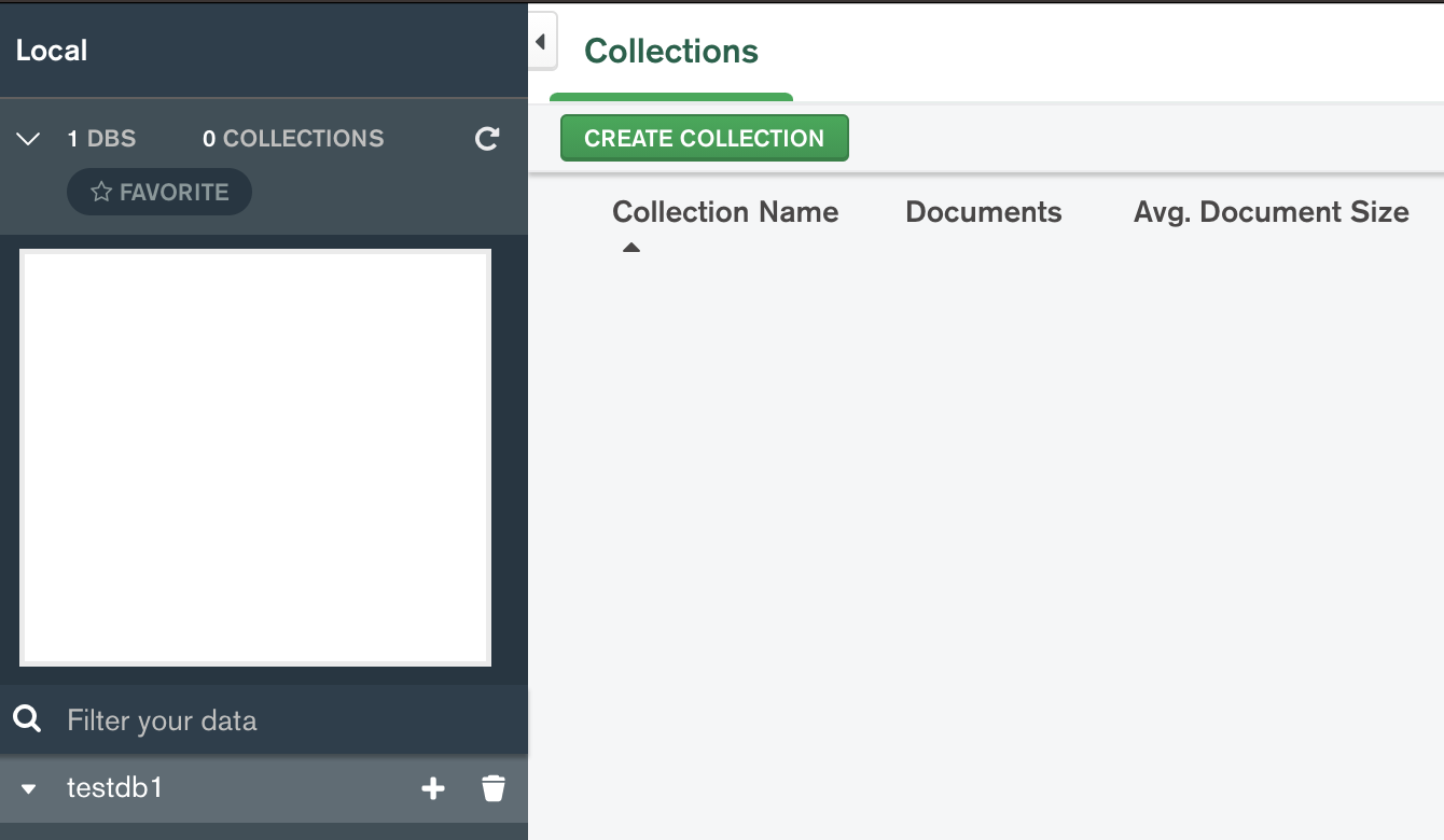

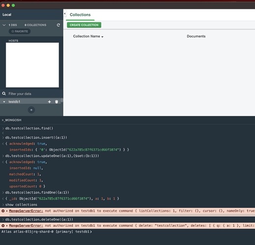

  3. Authenticated with Database User testuser to my test Atlas cluster connecting through Compass and the below is what I can see:
You can see in the terminal in Compass that the user was able to:
  • insert a document into a test collection in the database testdb1
  • find document(s) in the test collection in database testdb1
  • update the document(s) in the test collection in database testdb1
They were not authorized to:
  • use show collections
  • delete document(s)
Please take note that the authenticated user cannot see any collections in the Compass UI shown in the above example

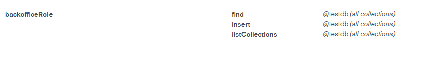

Could you show a screenshot of what you are seeing in Compass for both the database & collection sections (like the example screenshots below) and provide what version of Compass you are using? In addition to this, please confirm what actions are assigned to the database user when the screenshot(s) are taken. Please redact any sensitive or personal information.
I’m currently utilising 1.29.6 of Compass in my reproduction environment for this issue. With the following actions I can still see the database testdb1.
Although these are for testdb1 (all collections). The database I can see is testdb1 in Compass:
However, since I do not have listCollections action for the custom role assigned to my database user, it cannot see any collections (expected behaviour):

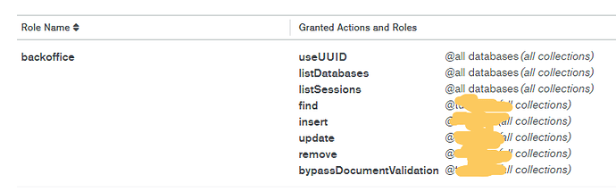

I had this same issue with my user not seeing the collections of my database in compass. I fixed it by specifying the database in the “Edit Customer Role” modal as “cluster0retryWrites=true&w=majority”.
You can find this cluster string for your specific database by navigating in your project to “Clusters” → select DB name → collections. The string will now be bolded above your table which lists all collections. Do not copy the end of the string that has the ., that suffix does not specify the db.
Here is what the working custom role looks like for me:
