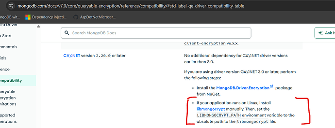

Thus, I used libmongocrypt library by building it from source, as mentioned here: GitHub - mongodb/libmongocrypt: Required C library for Client Side and Queryable Encryption in MongoDB
This has worked fine for explicit encryption, however, as soon as I have started using the automatic encryption with an encryption schema, I started seeing the following exception:
