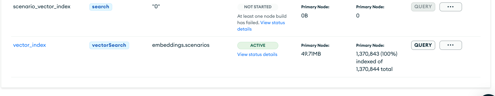

Also I noticed the method did not exists and I tried to use the one you mention instead. However this lead to creating a an index with the wrong type format (“search” instead of “vector”). As you can see in the picture attach. The first one is incorrect and creating with pymongo. The second one is correct and creating with the same parameters from the mongocloud GUI
Hey @Matthieu_Mazzolini , apologies for the delay here.
To execute the command via pymongo and have an type: vectorSearch index. For now, you will need to use the Database.command method and createSearchIndexes. Link to docs.
