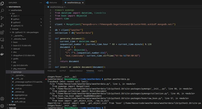

Thank you for this post. It appears to be exactly what I was looking for, to logg my weather station data to MongoDB.
I’m a NOOB, trying to setup your script on a Raspberry Pi. Tried running your script with my Atlas connection string, installing (using pip install pymongo and pip install bson) with and without venv and I get the same error:
MongoClient in pymongo not found and BSON not found.
I do run MS Code and when I copied the Python script into Code, it installed MS Python and I fear I could have multiple Python installations and that might be at least one reason.
I am pretty certain this is because you have a version of PyMongo installed alongside an incompatible version of the bson library (that PyMongo uses).
The quickest solution is probably to uninstall both PyMongo & bson, and then re-install PyMongo. You don’t need to re-install the bson library becaause it will be automatically reinstalled at the correct version.
Thanks Mark!
Looks like your suggestion worked.
Haven’t yet tried the provided script, but I managed to write a document to the db, using my test script.
