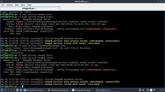

I have installed mongodb compass application, In which could not establish a connection. Also mongodb server status returns the failed status. I am using ubuntu 22 64 bit version. Please help me to fix this. I have shared my issue screenshot below.
ILL means illegal instructions

I installed mongodb version 4.4.8 this only works for me. I tried below commands, which works but I could not install latest versions like 5, 6.
When installing for V5 or 6, I got below error message.
Illegal instruction (core dumped)
There is any option to use V5 or V6. Please verify and let me know.
