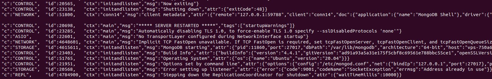

this is my network listen
this is my last mongo log :

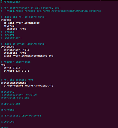

this is my mongod.conf

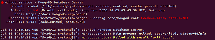

my mongodb.service

Hi @Quentin_Valenti and welcome in the MongoDB Community :muscle: !
First, looks like your mongod.service is failing to start because you already have another mongod running and using the port 27017 on this machine.
ps aux | grep "mongod"
This command above will help you find the other instance already running.
Second: You MUST activate the authentication! As you are apparently setting up a prod cluster, I would recommend reading the production notes. There are a lot of “details” to consider.
Cheers,
Maxime.
Hi @Quentin_Valenti,
In addition to the Production Notes as mentioned by @MaBeuLux88_xxx, I would also like to add that for any production-facing deployment, following the Security Checklist is also strongly recommended.
