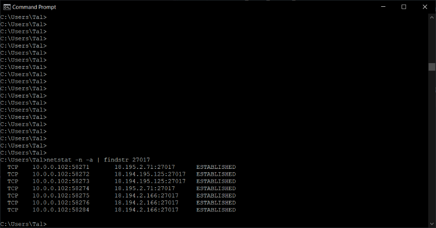

When connecting to mongodb Atlas, we can see that mongodb Atlas opens dynamic ports in our local machine in order to communicate.
In the screenshot, you can see that the servers in mongodb Atlas that opened the 27017 ports, are opening dynamic ports to our local machine (i.e. 10.0.0.102) that are probably necessary for communication.
In our case, it is known that ProtonVPN is blocking all ports through their firewall by default, thus they are not allowing mongodb Atlas to open the dynamic ports it wants for establishing the communication. And this results with a connection timeout, and a failure.
So unfortunately, because there is no option for ProtonVPN to open dynamic ports, there is no option to connect to mongodb Atlas through ProtonVPN.
I’m having the same issue, also connecting with ProtonVPN. Is there anything that can be done to workaround this @Andrew_Davidson?
All the above text about have to open dynamic ports to established an outgoing connection to port 27017 shows a lack of networking knowledge. The port that needs to be open is 27017. Do the same netstat/findstr with https. You will see a bunch of 10.* dynamic port ESTABLISHED to what ever IP:https web site you have. ProtonVPN does not open each and everyone of what you call dynamic port, it opens https.

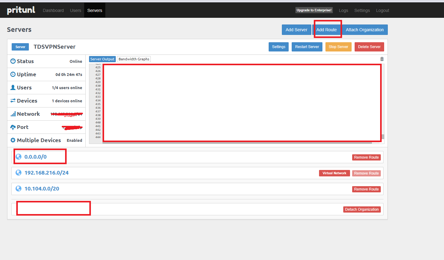

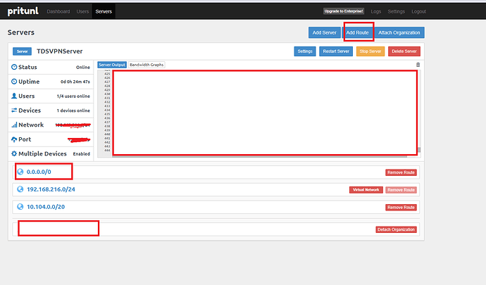

Hi! I use DigitalOcean’s Managed MongoDB. and I use Pritunl VPN Server, I solve this issue by adding a route 0.0.0.0/0 in my Pritunl VPN Server as you can see in screenshoot
Hope it helps
