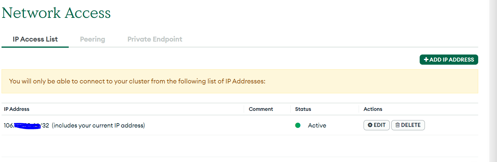

when I use 0.0.0.0/0 (Allow access from any where its working properly) but when use my current IP its triggered Error
Also Please check below another one image. (per single post it allow only one img so posted one by one)
The IP you are whitelisting may not be the public facing one
Check with your network team or others with network knowledge can help you better
Does ip you have whitelisted match with whatismyipaddress?
A note here, the IDE for the course is not using your IP address. You need to open up 0.0.0.0/0 unfortunately for using the course. You can make that change temporary (I would recommend this) by toggling the slider in the lower left corner and choosing one of the available time values:
