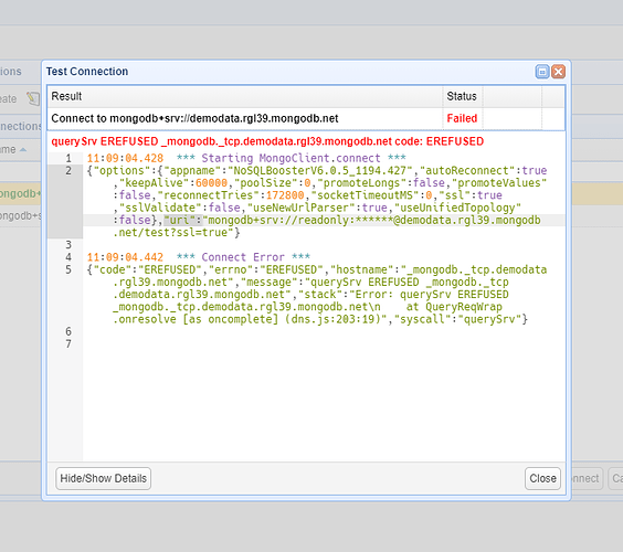

i have installed NosqlBooster and trying to connect to altas rarely its get connected
I have whitelisted IP addresses as well as created different database users ., Tried VPN , tried firewall and antivirus enable and disable but not worked for me.

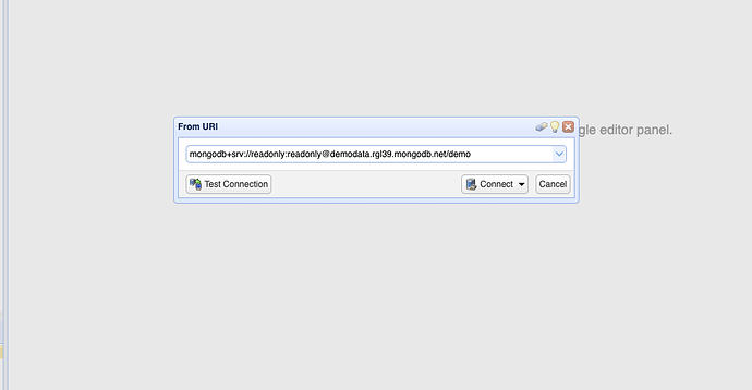

I just downloaded it and connected to both a localhost MongoDB and an Atlas Cluster with NoSQLBooseter. I run a public read-only cluster at mongodb+srv://readonly:readonly@demodata.rgl39.mongodb.net/test can you try connecting to that cluster to see if it works? (yes. the username is readonly and the password is readonly, you can only query this cluster). I just verified it works with NoSQLBooster (Version 6.2.13 (6.2.13)) for me.
Try switching DNS provider by using Google’s 8.8.8.8 and 8.8.4.4. It looks like your current provider does not support the new seedlist feature of modern name servers. If that is the case I would also be scared of un-installed security patches.
