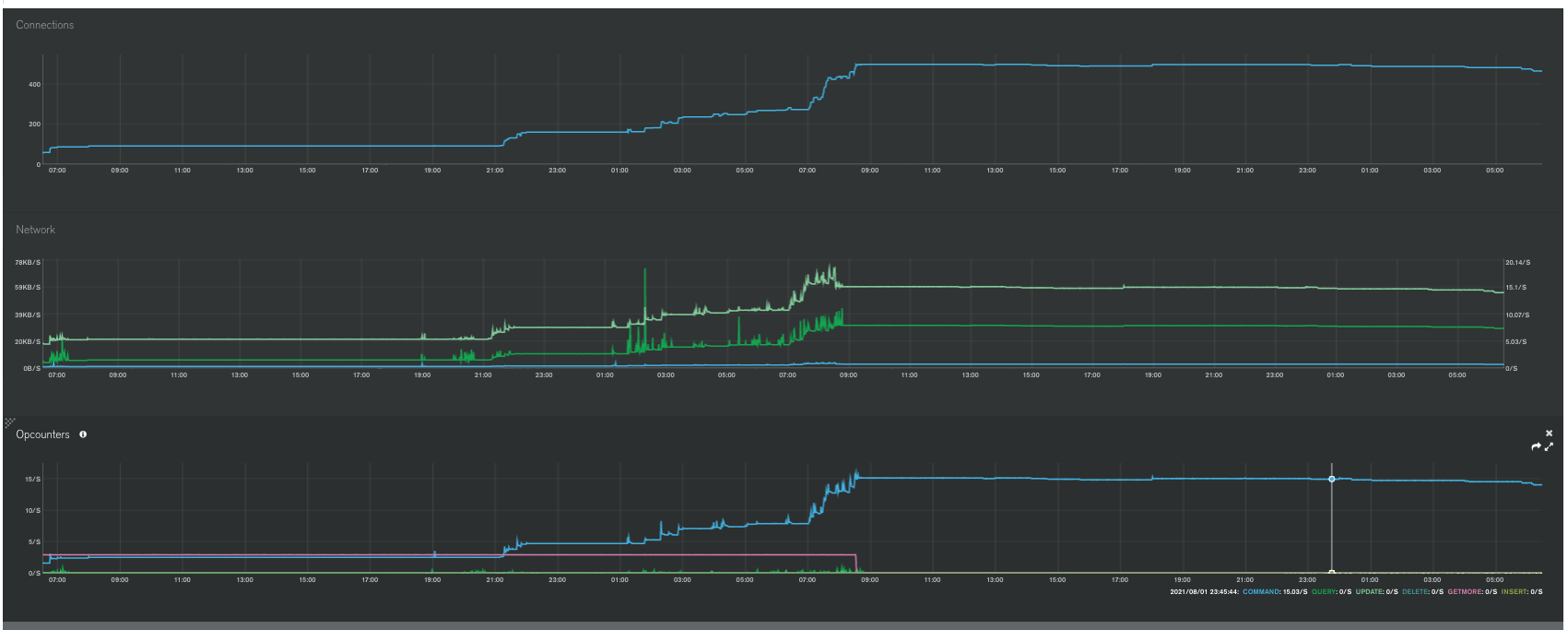

Hi everyone, I’m encountering a VERY strange “connections to your cluster(s) have exceeded 500” in my M0 cluster, and can’t seem to make it go away no matter what I try. For context, our atlas cluster is accessed exclusively through a Mongodb Realm app, through the app.currentUser. We use realm-web v1.2.1 nodejs driver.
A few puzzling things about my situation:
there should be no users currently using it, it’s a development instance and both developers were offline/asleep. Even so, it’s maintained ~500 connections for the last 24+ hours
the only op type in the Opcounters graph is “commands”. There are no queries/deletions/updates/etc for the last 24+ hours, yet there is consistently 15 “commands”/second to the cluster somehow.

Finally, I disconnected my Realm app from the atlas cluster as a data source entirely. Finally after this, the # of connections is going down by about 3 per hour.
Does anyone have any guidance on what could possibly be going on here, and what I can do about it? The opaqueness of the situation is a bit frustrating. We were pretty sure we were going to upgrade to M3+ eventually once the app had a real launch, but need to be confident we can work through critical fires like this.
