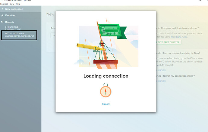

When I tried to connect to cluster using compass I am getting timeout error.
` buffering timed out after 10000ms
Below image is what I am getting when I try to connect to cluster using Compass.
And also in the recently used section contains the deleted cluster which I mentioned in the first point.
Have you change computer, internet provider, vpn provider or location? It looks like a networking issue from your side.
Both clusters seem ok. Perhaps cluster0.egv6d.mongodb.net was created in another project. That would explain why you do not see it in Atlas.
You prob need to change your IP. Anytime you get that error is related to the network access. Try 0.0.0.0/0 as it will include your current IP address. It usually works.
