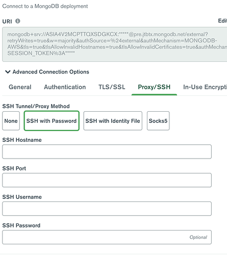

I’m using MongoDB Compass and configured the SSH (in the Advanced Connection Options/SSH tab) so the host is a host which its IP is whitelisted in the MongoDB Atlas cluster. The SSH connection is established successfully.
I’m not using an ordinary SSH tunnel, as described in the link provided.

No… it’s in Compass
It should be the native way to connect through SSH.

First, thanks for this image, I did not know Compass could do that.
Second, this is still the same as putty or other ssh commands. Compass uses your dev pc’s ssh port to tunnel to that host, but it connects to a data port on that machine that is supposed to run a mongodb server. Since this middle host does not run data server, hence comes the connection error.
you need to “also” set that host to forward that port you try to connect from Compass to Atlas cluster’s port. this is the second leg of forwarding you are missing.
