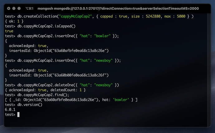

Thanks @Josman_Perez_Exposit I tired using that syntax, with the same results.
I’m using 6.0.1 (via Docker).
Out of curiosity, I also spun up a 5.0.14 container to test, and it worked the same.
I could delete documents in capped collections.
The process in 6.0.1:

Any thoughts @Josman_Perez_Exposit … is this ability to delete something newish with capped collections or ???
Hi @Justin_Jenkins, sorry for the delay. I have indeed reproduced and scaled it internally. I want to inform you that MongoDB > 5.0 removed the restriction on delete operations in the apply operations command.
However, we don’t seem to have added this to the documentation yet. I’ve filed an internal ticket to update the documentation to reflect this to avoid confusion.
