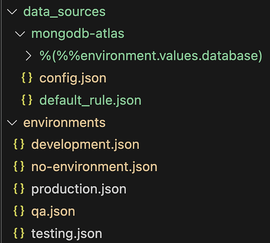

Thank you for that information. One followup question however, is the file really stored in a directory with the string %(%%environment.values.database)? Your example shows:
demoapp/data_sources/mongodb-atlas/%(%%environment.values.database)/Demo/rules.json
Which seems a little odd to me.
Thanks again!

Yes.
True, changing environment after deployment will not change your database. These values are for deployment with realm-cli. On the other hand, you can deploy multiple versions of the same app to the same project, each with any environment/database you want.
