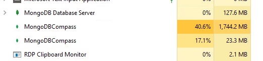

I have one server that will not launch any version of mongodbcompass. Last successful version that opened on that server was 1.26.5, which I installed and opened, did what I needed to and then closed everything and logged off the server. Tried opening it a few days ago and it just spawns tasks in Tasks Manager but never starts or shows the GUI. I tried upgrading to 1.30.1, nothing. Rolled back to 1.26.5, nothing. Tried all of the release in between and each does the same thing (nothing but spawn tasks) so I think there is something installed that is not written over that I am not getting and its causing the problem to continue with each version. I’ve deleted the folders create in the user’s local and roaming folders, but still, no GUI. The tasks in the manager keep growing until I cancel them. 1.30.1 installed on other servers works fine… for now.

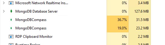

There really is no screen shot I can show- it would just be my desktop because compass NEVER opens… the only hint that something is occurring is the tasks in the Task Manager:
@Jeff_Kling sorry for the late follow-up. We are currently investigating this. Question: did you install Compass with the EXE or with the MSI installer?
Hi There! No worries. I have been chatting with Felicia on the Jira bug tracker here
and she suggested trying the beta release and it has been working as it should so I think they were able to fix the issue.
For your question, I tried both installers and got the same result for each when I had this problem.
