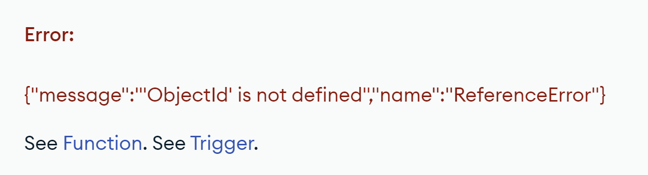

If restaurandId is a string like "6380b9bd3b0718df59e5b71d" you simply have to call the ObjectId constructor like
const restaurant_id_as_string = "6380b9bd3b0718df59e5b71d" ;
const restaurant_id_as_oid = ObjectId( restaurant_id_as_string ) ;
const restaurant = await restaurants.findOne( { _id : restaurant_id_as_oid } ).then(res => {
    console.log(res);
I have tried this and got this error:
Sorry, I missed the part that you are not running this in the mongosh or nodejs.

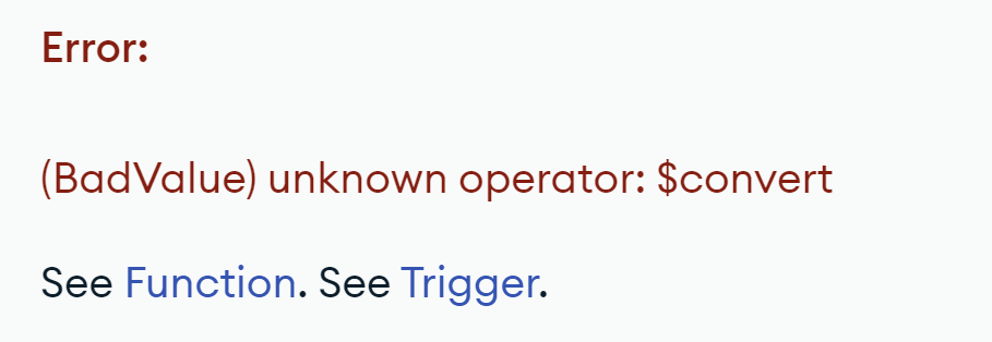

Try with $convert:
const restaurant = await restaurants.findOne( { _id : { "$convert" : { "input" : restaurantId , "to" : "objectId" } } ).then(res => {
    console.log(res);

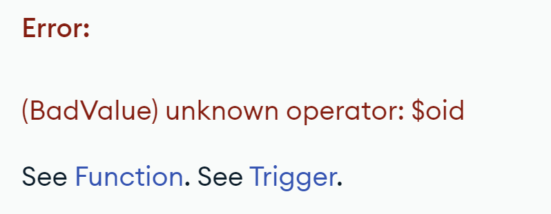

you can also use $oid if restaurantID is a legit ObjectId
restaurants.findOne({ "_id": { "$oid": restaurantID } })
It does not work inside function. Do I need to add some dependency?
Does not work with “$oid” either
did you use them in quotes?
we use them all the time in queries outside Realm, so logically they should work there too.
It seems Realm functions fail to process queries as we know them. Even official docs are vague about it. For that, it is unfortunate I do not have an immediate answer for now.
