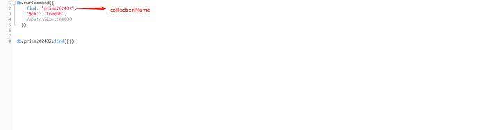

Hi @steevej
Are these two statements equivalent? Why is the total number of queries inconsistent,
Thank you for your answer just now
Please do not publish screenshot of code or sample documents. It is completely unusable. Read Formatting code and log snippets in posts so that we can work with what you publish.
According to the explain plan, they are not. If you insist in using a low level API like runCommand() rather than using the friendly find() you will have to
