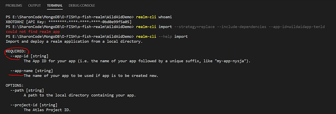

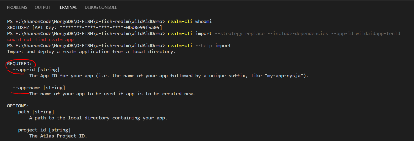

This project is awesome! I’m trying to build my own OFISH instance following the github site instructions. So far so good until I reach step 6 to import realm code. I’ve changed the command line from stitch-cli to realm-cli but still no luck.
stitch-cli import --strategy=replace --include-dependencies --app-id=REALM_APP_ID
realm-cli import --strategy=replace --include-dependencies --app-id=REALM_APP_ID
Question is, do I need to provide --app-name as well since it’s required? Or maybe some of the configuration.json file is wrong. Thank you!
Hi! The app name should only be required if the app is new. The instructions were tested but it’s possible things have changed with a new version (old version was called stitch-cli, new version is realm-cli). We will look into it.

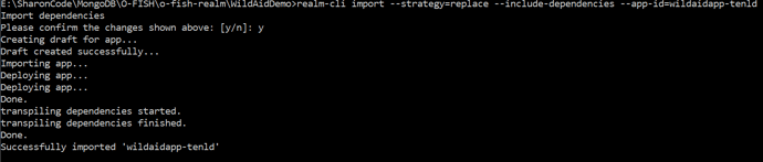

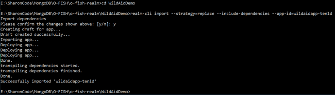

Hi @Sheeri_Cabral Thanks for your follow up. I did the git pull again but couldn’t get it work. It said successfully imported however when I went to atlas to check the functions, it’s empty

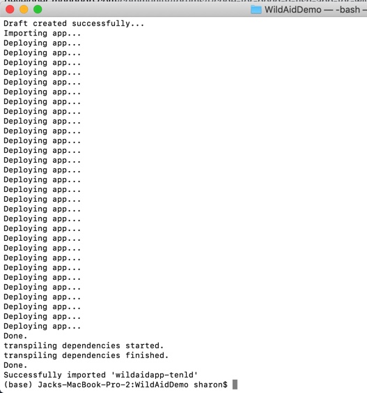

So I found a Mac, followed the build steps from scrach, installed node.js and realm-cli. It said Successfully imported ‘wildaidapp-tenld’ but when I tried to verify the functions, it’s empty.
Hi @Sheeri_Cabral, it’s working after I re-cloned the repo and re-imported the data. Yay! Thanks for helping me out. I’ve tested the web app and it connects to the Realm data just imported (7 collections in total and 3039 documents in BoardingReports). Now I have the environment set up and please let me know if I can be any help with this project. Thanks again!
