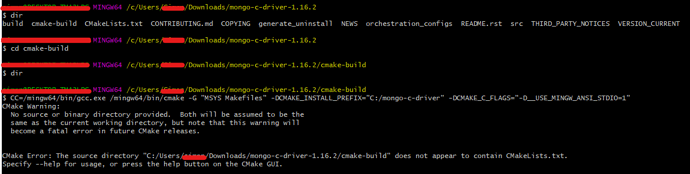

I am new to MongoDB and I’m trying to install the mongo-c-driver and the connector.
But I always get the following CMake error:
Does anybody have a idea how to fix it?

Hi @Simon_Reitbauer,
The installation instructions have the last argument to the cmake command as the path to the directory containing CMakeLists.txt. Try adding .. to the end of your cmake command.
Thank you, now it’s working. Totally forgot that.
