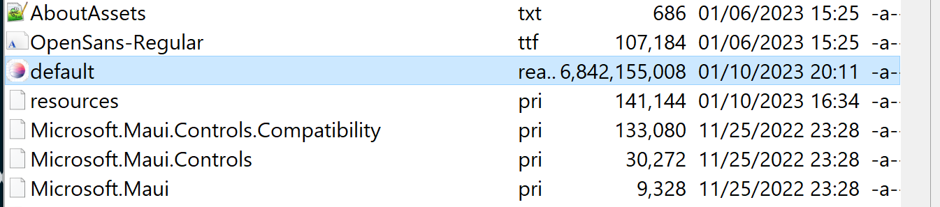

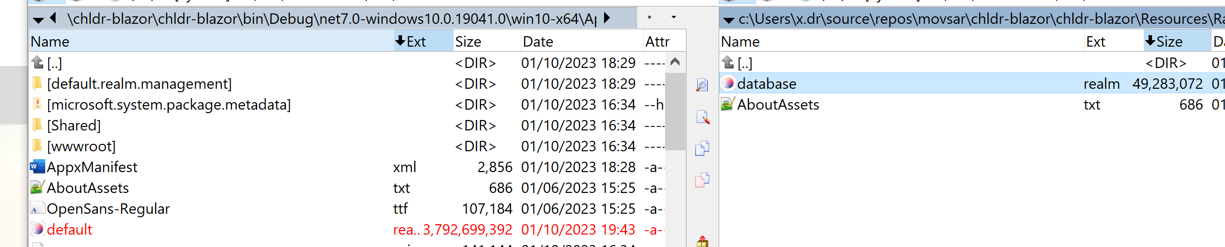

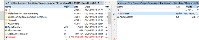

So at this time the sync process created a 3Gib, out of original 49Mb file, is that okay? How big this file can get? It’s still running - expanding.

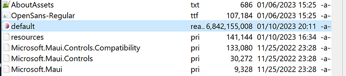

I waited until it got 6Gb - there’s clearly something wrong with this sync process, it doesn’t log any errors, just keeps on writing stuff.
