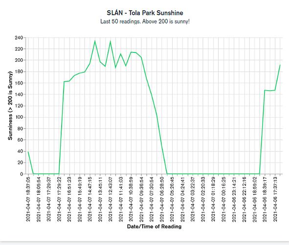

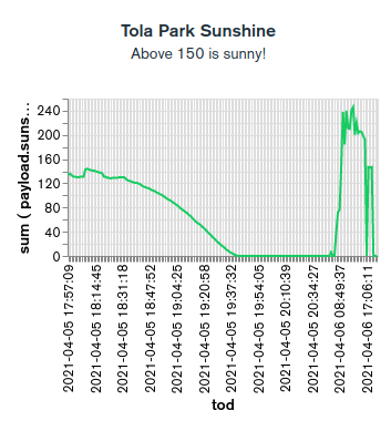

My problem is that while my value (Y-axis) over time (X-axis) line graph looks right the time labels are jumbled up. This doesn’t happen if I render the same data as a text table. Have I done something daft?
Thanks for reading this. Here’s a screenshot.
Tony
Ah I think the line graph is in ascending value while the text chart is in ascending date. Hopefully I’ll find out how to fix this and remove this post :slight_smile: Again I’m new to Charts.

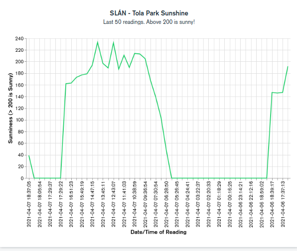

Solved it. Needed to select CATEGORY rather than VALUE for the X-axis. Still writing this got my to focus on the problem and may help some other newbie :slight_smile:
Graph nnot_a_bug_Screenshot from 2021-04-06 21-04-43 ow looks good!
Great stuff! Note that it only defaulted to the Value sort because your X values are strings. If they were dates, it would always show them chronologically, and also unlock additional options such as Binning.
Even if you can’t change your data to use the correct Date type, you can still convert the field type directly within Charts. Just click the … button on the field in the left panel and choose Convert Type.

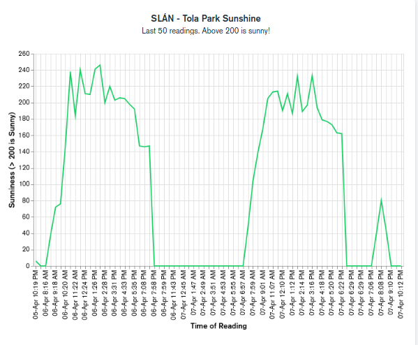

Thanks Tom. Wow! There’s a lot of power lurking in filter/custom. I even manged to apply Irish Summer Time and remove the year.
I’ve learned a lot thanks to your help the last two days and can now show and promote these graphs to others.
