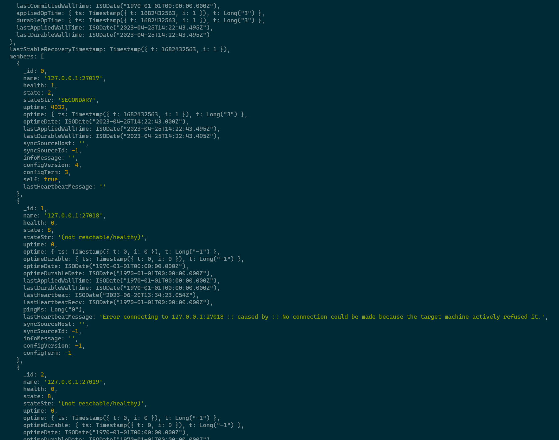

so i have my port 27017 and it is secondary (i’ve done something in the past to it but i forgot), i cant change it back to primary. Plz help me
( I have try rs.stepDown() and reconfig but it always said that cant run those command on secondary must be on primary)
This is my rs.status()
In the current state you can’t, and the reason is because you only have 1 of 3 nodes available. When you don’t have a majority of nodes healthy the cluster can’t have a primary. You need to bring up one of the other nodes to a healthy state. Then you will have 2 of 3 nodes up so you will have a Primary and a Secondary.
