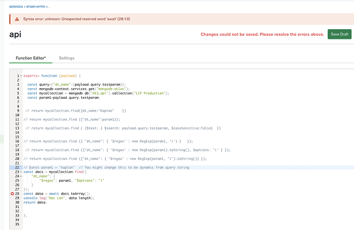

Your proposed code as a Realm function yields this:
Realm looks like this:

That code in Realm gives me this error shown on top:
Ah that’s on Realm Function Editor! My bad. Even I’m new to that tool as well ha ha
