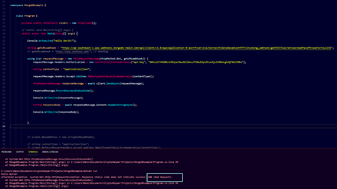

So I decided to try using HttpClient, below is my code:
(I don’t mind showing my passkeys or api keys because I can change them later.)
    static async Task Main(string[] args) {
        Console.WriteLine("Hello World!");
        string getURLwebhook = "https://ap-southeast-1.aws.webhooks.mongodb-realm.com/api/client/v2.0/app/application-0-eprrf/service/ConnectToDataBaseOverHTTP/incoming_webhook/getTEST?secret=secreatPassPhraseForYou1234";
        // getURLwebhook = "http://www.contoso.com/"; // testing
        using (var requestMessage = new HttpRequestMessage(HttpMethod.Get, getURLwebhook)) {
            requestMessage.Headers.Authorization = new AuthenticationHeaderValue("api-key", "bNKzoZTHRdDGLVrBCywr9avGbl5bvufY58uG3yxOtux4juStNNeLgteQf66i3MOs");
            string contentType = "application/json";
            requestMessage.Headers.Accept.Add(new MediaTypeWithQualityHeaderValue(contentType));
            HttpResponseMessage responseMessage = await client.SendAsync(requestMessage);
            responseMessage.EnsureSuccessStatusCode();
            Console.WriteLine(responseMessage);
            string responseBody = await responseMessage.Content.ReadAsStringAsync();
            Console.WriteLine(responseBody);

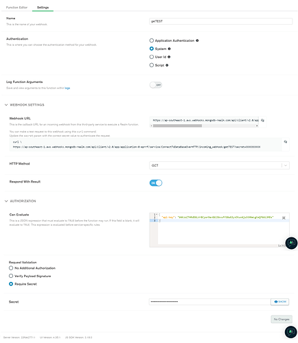

Here is my code in the Realm WebHook Function
exports = function(payload, response) {
  const mongodb = context.services.get("mongodb-atlas");
  const mycollection = mongodb.db("AccountCooldowns").collection("AccountCooldownCollection");
  response.setStatusCode(200)
  return mycollection.find({}).limit(10).toArray();
When running this code with the run button, it works perfectly.
Here are my settings:

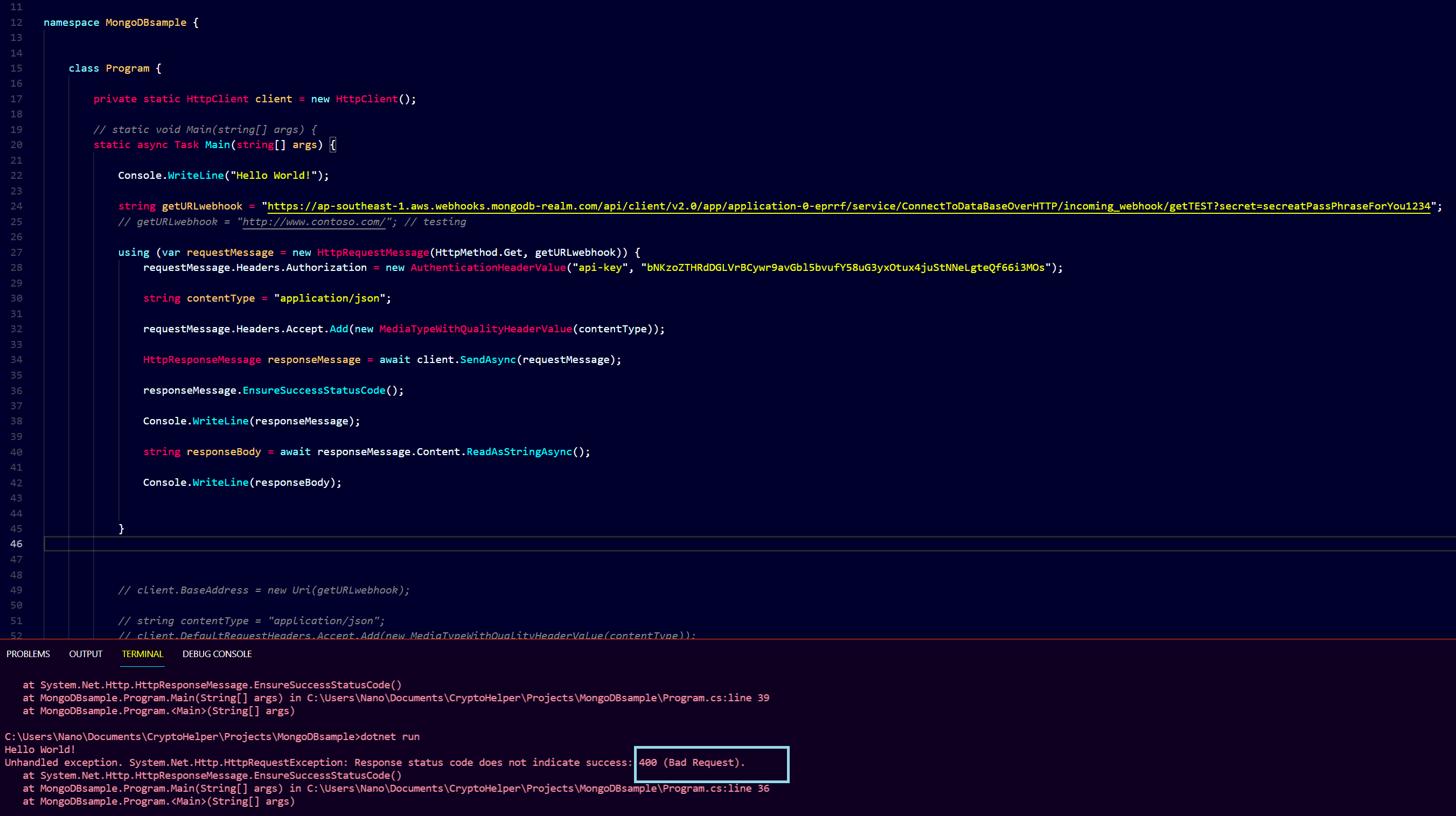

When I run the C# code it will always return this error:
400 Bad Request
