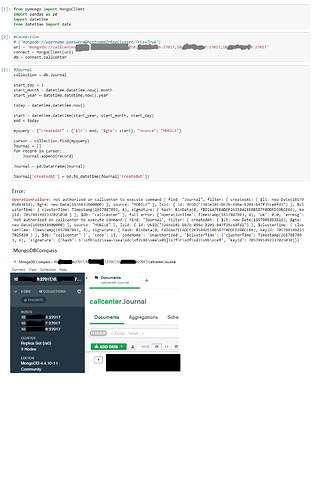

Here it is
This is a but different from your original post. You are not connecting to a standalone instance like hinted by your original URI. You are connecting to a replica set. The issue might simply be because you are not specifying the replica set name in python. You seem to do it with Compass.

I have added replicaSet but nothing changed.
#Connection
uri = ‘mongodb://callcenter:password@example6:27017,example7:27017,example8:27017/callcenter?readPreference=secondary&authSource=admin&replicaSet=rs0’
connect = MongoClient(uri)
db = connect.сallсenter
I still have an error: not authorized on сallсenter to execute command

I checked the connection string. It`s correct. With this conection string I can connect to db using QlikSense. And I connected to db using MongoDBCompass using this string
Just discovered that if I specify only one server, not three, then everything works fine. So, the problem is that I wrote three servers. How can I specify three servers in one connection string? Maybe you know some features?
if there is no typo, your above URI string should have no problem connecting to a replica set.
The error you are getting is about the auth. It is possible your user is not set up correctly and one or more replica members do not know how to deal with it. or maybe the replica set is not set up correctly.
You said you can connect to one of them if you use single hostname. Can you try to connect each of the members separately?
