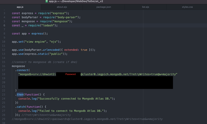

Here’s my app.js connection code:

For some reason, the connection code screencap is not visible in the first post. Here it is again:
