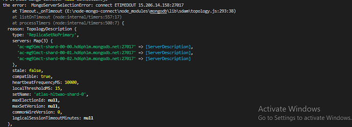

When I try to connect mongodb with node I get this error.In picture
In many tutorial I have seen the solution of the problem can be found by whitelisting the ip address. but trust me I did but nothing happened.
Hello @Riyad_Sm and welcome to the MongoDB community forums.
Can you use mongosh from that machine to connect to your Atlas cluster? Have you temporarily added 0.0.0.0/0 to the allow list to see if your Node app could connect? Are you behind a firewall or proxy that is not allowing your connection to go out to the MongoDB cluster?

If you are running the code from your house you probably don’t have a firewall or proxy in place, especially if you’re not sure. If you’re running code from a work location however, you might be going through a proxy. You would have to ask your network team.
Note that I am able to connect to that cluster (I can’t do anything as I don’t have the credentials), so it appears that you do indeed have the server open to the world for anyone to access.
I would recommend restricting access only to the IP addresses that should be able to access this data. This is extremely important if you plan on having sensitive data stored in the cluster. I would recommend this even with authentication enabled.
As for your code, I’m not a Node developer (I’m an admin/ops guy) so I’m not sure if your code is valid or not.
@Doug_Duncan Yes. I am using from home. My code is correct as far as I know. But still I am getting the error.!!
I am not sure why you’re getting a time out error. As you can see I was able to connect to the server so the server is accessible from anywhere. I just copied your code and was able to connect to the server without issue, so the code works as well.
If you are getting a time out error from running the code then something on your end is blocking the connection from your machine to your atlas server.
What happens if you run mongosh mongodb+srv://cluster0.hd6phlm.mongodb.net? Do you get a connection or do you get a timeout?

As both I and Ramachandra can connect to your Atlas instance, there is nothing from the MongoDB Atlas side that is blocking your connection. This would mean that there is something on your side that is blocking the connections. If you have disabled the firewall and you’re still not able to connect, you might be going through a VPN that is causing issues with you making a connection.
