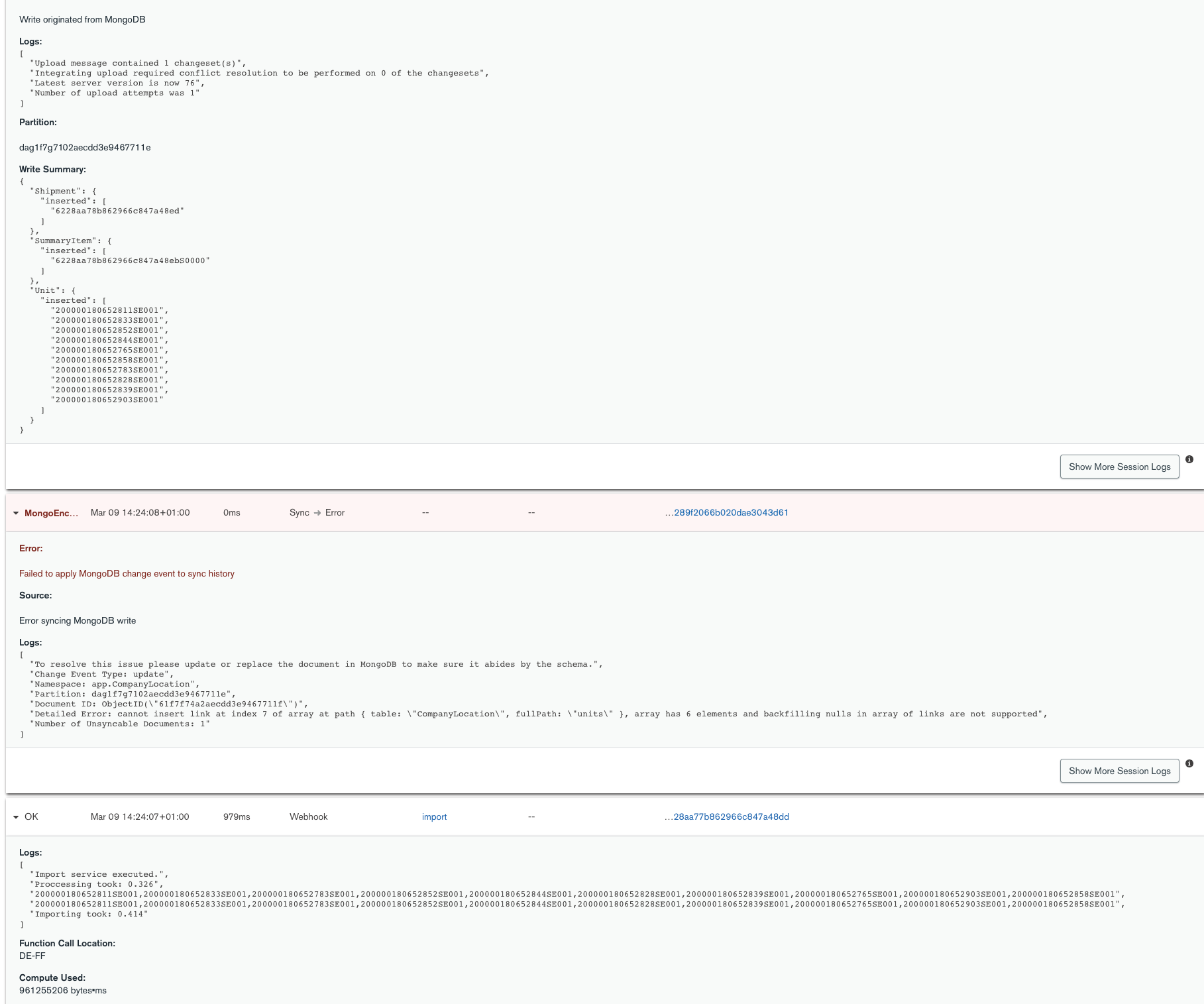

Hello, thanks for a quick reply!
The array does not contain any null values. Anyway, here is the output of the console logs:
200000180652811SE001,200000180652833SE001,200000180652783SE001,200000180652852SE001,200000180652844SE001,200000180652828SE001,200000180652839SE001,200000180652765SE001,200000180652903SE001,200000180652858SE001
Here is an image of the full log history.
(nothing here is sensitive, it’s a test enviroment with mock data) :slight_smile:
Thanks!
