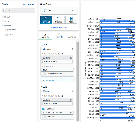

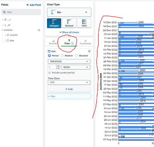

Hi
take a look at these pictures. First one shows what is on axis, second the filter.
Axis
Filter:
Thanks, this helps. The reason this is not working as expected is because your dates are stored in an array. The filter is being applied before the array is unwound so it is filtering for documents where any element of the array meets that criteria, and then when the array is unwound you are seeing some values that do not match the filter.
The solution is to unwind the array in the query bar rather than using the Array Reductions option. You can do this with the following query:
[{$unwind: "$auctions"}]
This will ensure the array is unwound before the filter is applied, so it should filter out all the values you expect.
HTH
Tom
