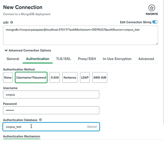

I’m trying to use a simple Java program to connect to a MongoDB hosted on my Mac accessible by Compass using the authentication user and password I set up.
However, in the JDBC code, I get the error 18 (authentication failure). I have no idea why. Same connection string as in Compass.

See my posting (sorry, was posting when you wrote your reply) I added. I can connect, using Compass using these credentials.
When I click “Connect”, it connects with no problems.
(The actual password is “passpass” for testing.)

If you check the screenshot I posted above, you see that I did, in fact, create the user in the corpus_test database. Other than that, I have no idea what to try. I’ve used every variation on the JDBC string I can think of.
