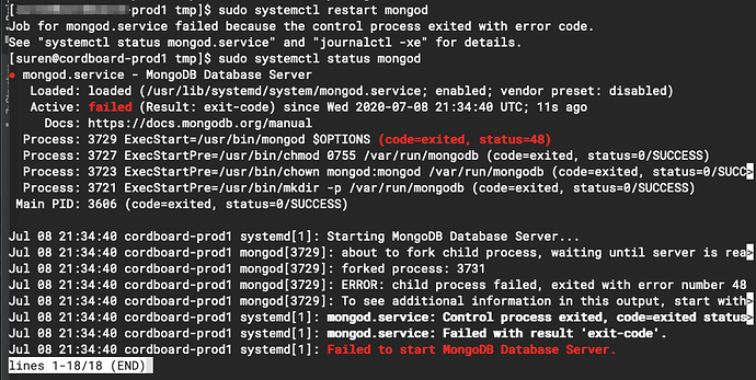

Shows the below error:

Hi @Suren_Konathala,
Can you check the MongoDB server logs for more details on why the service isn’t starting? The default location on CentOS should be /var/log/mongodb.
You can include multiple bind IP addresses in a comma-delimited list or alternatively use net.bindIpAll to bind to all network interfaces on this instance. A cloud instance typically will not have a public IP until you explicitly add one, and you would want a static IP (see: Google Cloud: Reserving a static external IP address) if you are using that to connect to your MongoDB deployment.
Before binding to a public IP, I strongly recommend reviewing the MongoDB Security Checklist and ensuring you have enabled authentication, configured role-based access control, and set up TLS/SSL.
If a bindIp directive isn’t working (and this is the only value you’ve changed for a previously working configuration), some common reasons are:
  • You are trying to bind to an IP that isn’t associated with a local network interface on this instance (the IP address should appear in the output of ifconfig -a | grep "inet").
  • There is a running process already bound to the requested IP and port number.
  • You have a syntax error in your MongoDB config file.
  • You aren’t editing the correct config file (which doesn’t appear to be the case here). /etc/mongod.conf is the default on CentOS if you installed the official MongoDB packages and are starting as a service).
If you are still having issues, please share the relevant lines from the MongoDB log which should include the reason for the mongod process shutting down. It is also easier to review if you can share log lines and similar information as text rather than images.
Stennie
Yes, this is definitely a problem with network configuration for the VM.
The MongoDB startup exception indicates that the requested IP address is not a local network IP that can be assigned by the bindIp directive:
Failed to set up listener: SocketException: Cannot assign requested address
From your screenshot, it looks like you may have set up SSH port forwarding from an external IP address to the internal IP address. If so, your VM would not have a local network interface associated with the external IP: all requests will be forwarded via SSH and (from mongod's point of view) appear to be coming from localhost or the private IP.
If your intent was to add a public external IP that allows direct connection to your deployment, the Google Cloud docs I suggested earlier should be helpful. You may want to contact Google Cloud support for further guidance on creating your desired network configuration.
