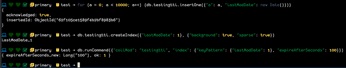

Hi @Vartika_Malguri have you tried running something like the following (taken from the TTL Index documentation):
db.runCommand({
"collMod": <collName>,
"index": {
"keyPattern": <keyPattern>,
"expireAfterSeconds": <number>
This will go through and update an existing index with the expireAfterSeconds field. I just tested this out on a normal index and the document was deleted after the expireAfterSeconds period passed.

Can you state what version of MongoDB you’re using? I just tested this out on version 6.0.0 and it worked.
Quick note, I just tested with versions 5.0.10 and 4.4.15 and was able to do the same as I did on 6.0.0 and the process worked on those versions as well.
