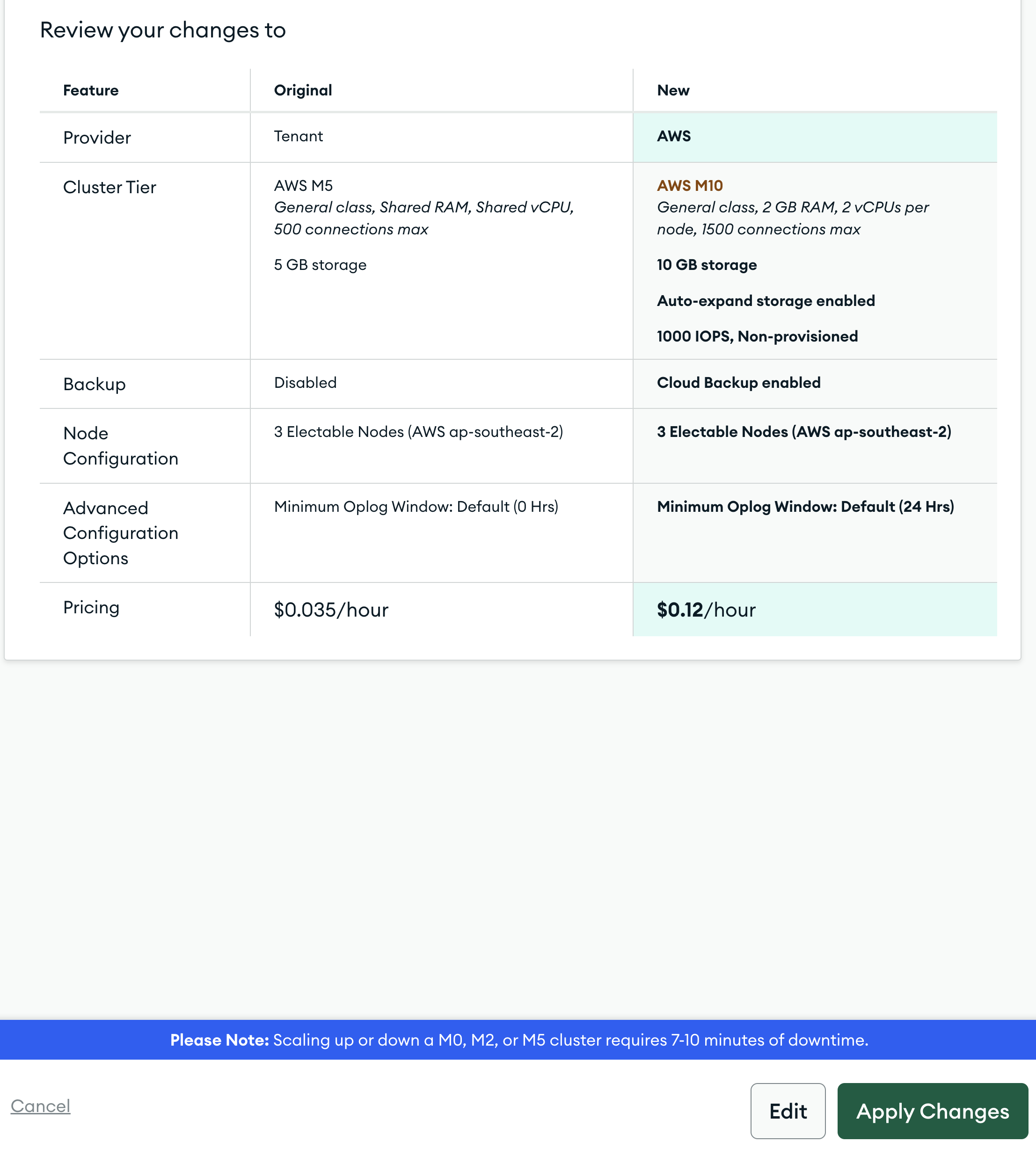

It is possible to upgrade from M5 to M10 but it is a scenario where downtime is required as noted in the Modify a Cluster documentation (first dot point below):
Changing the cluster tier requires downtime in the following scenarios:
- You change from an
M0free cluster orM2/M5shared cluster to anM10or larger cluster tier.- You change from an
M0free cluster to anM2/M5shared cluster.- You change from an
M2shared cluster to anM5shared cluster.
Note: There should generally be no downtime associated with modifying the cluster tier when doing so for M10+ dedicated tier clusters
For example, please see the below screenshot regarding an M5 to M10 upgrade from the UI from my test Atlas project:
