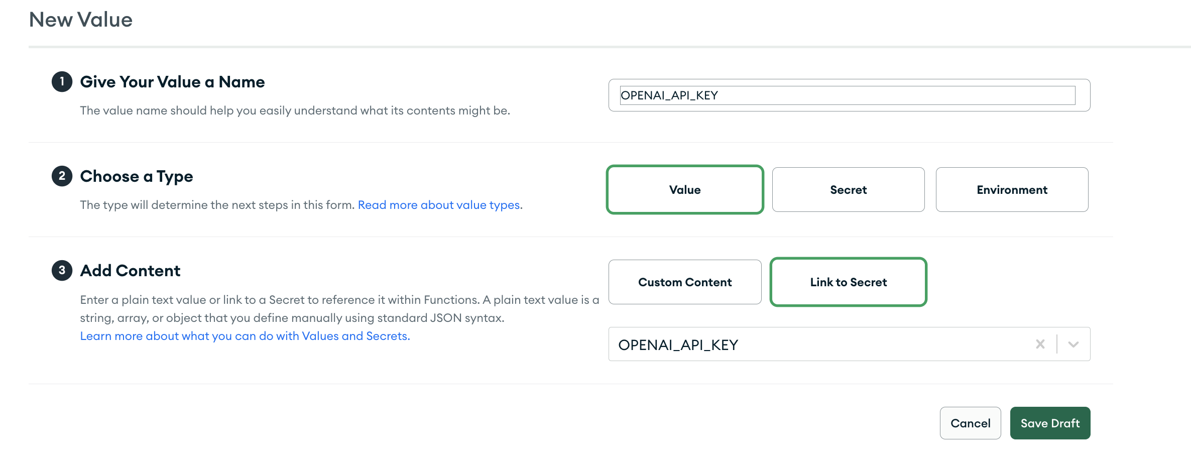

  2. Store your OpenAI API key as a secret — left sidebar > Values. Note that to be able to access the secret through the function, you should:
    1. Create a “Secret” with the actual content of the API key.
    2. Create a “Value” that is linked to the secret.
  3. Use a function implementation similar to the following to send requests to the OpenAI API.
