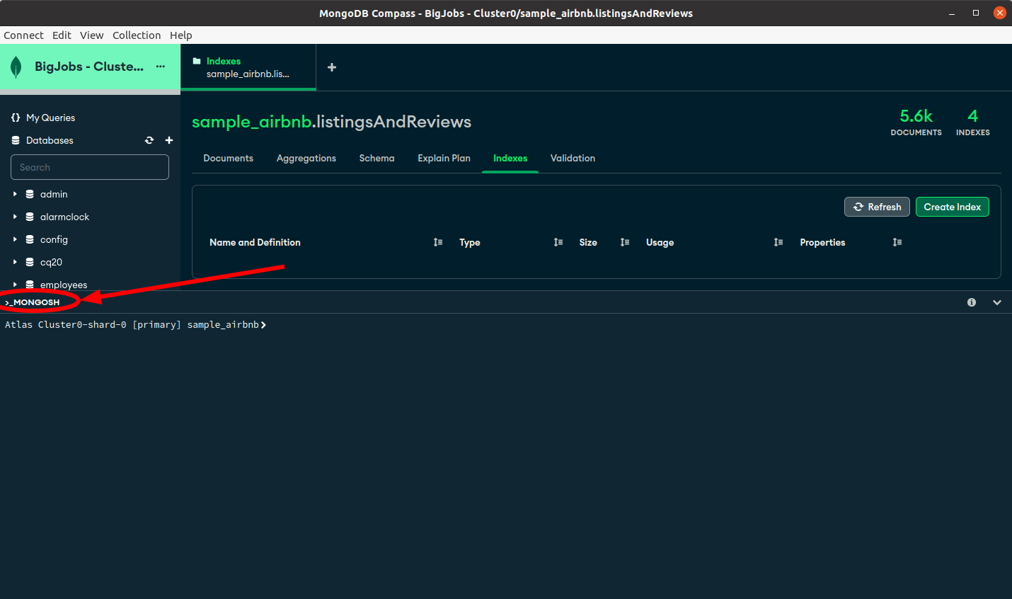

Hi @javier_ga
That is the mongosh method. You can do that in compass using its builtin mongosh.
Look to the bottom of the compass gui and you will see mongosh, click to expand this.
For now, the solution is what @chris suggested.
Soon, Compass will have a built-in way to create Search indexes in the UI. Stay tuned for that!
And yes, Compass can connect to Atlas.
