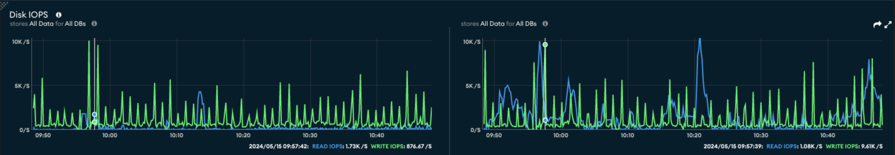

cache activity on primary node I see like read into as 1.87GB/s and written from 206.488B/S
Different peaks for read/write IOPS. Peak read IOPS like 8.87K/s and write max is around 9.61K/S
