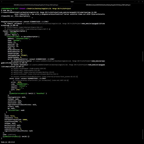

Can anyone fix the error why am i getting this

I run mongod and in other tab when i run node app.js then i am getiing this below errorCcn Any one please fix this or help me in fixing this
I am unable to connect to DataBase.
Please Help !!

Hi @Abhishek_Jain4,
It looks like it’s trying to connect on an IPv6 interface, but this is failing (ECONNREFUSED ::1::27017). The driver won’t fall back to IPv4 in these cases (see NODE-4678) so a quick fix is to change your connection string to "mongodb://127.0.0.1:27017" and reconfigure your replicaset (replSetReconfig) so the host details also reference the IP address.

Still not able to connect. Can you help more. Please!!
