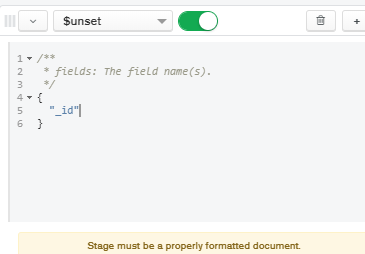

Other quick question:
Why the heck does unset say it is not properly formatted:
That is an aggregation query you had tried. The Aggregation Update is like the following update statement, which changes the data in the database:
db.collection.updateOne(
  { _id: "some value" },
      { $set: { .... } }
Also refer:
