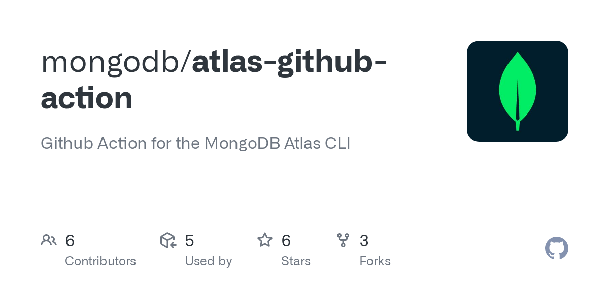

I am in the same position - I see there is a GitHub Action now, however it only supports remote Atlas clusters, not the local ones from what I can see.

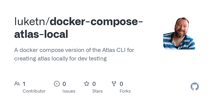

It would also be great if the settings required to run the containers which Atlas CLI local deployments use could be shared. I can see they are started up with some environment variables, some keyfile credentials to talk to one another.
Here’s my attempt at a docker compose file that matches what the Atlas CLI does in case it helps:
