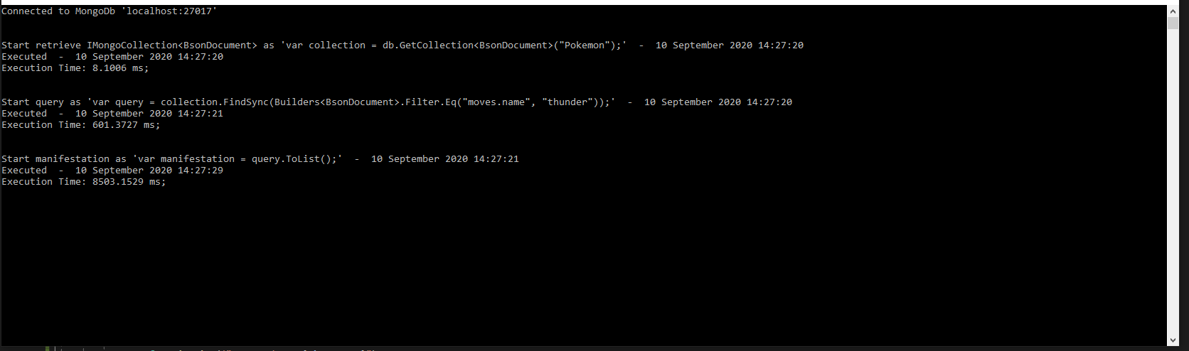

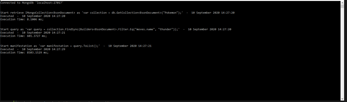

So, as I wrote I am doing this in a ConsoleApplication NetcoreApp 3.1.

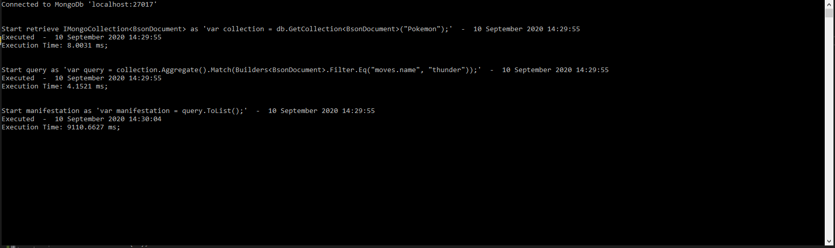

I executed 2 different ways of querying, one with FindSync() the other with Aggregate().Match().
The first one (FindSync):
The second one (Aggregate):
