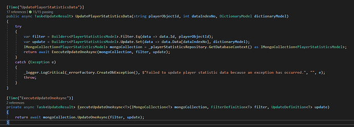

I’m having a long execution time on UpdateOneAsync in c# driver. From data analytics I can check that the execution in the mongo db itself only took 100ms, but when I stopwatch the UpdateOneAsync in the code it took 3.5 secs!

Thank you for the answer. Yes, I am reusing the Mongo Client. The serialization itself is not deep and not large. Or is my method of how replacing one array of data wrong?
