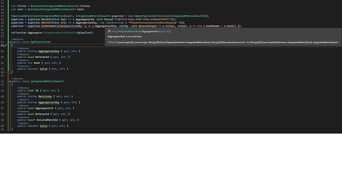

I’m trying to create a query in C# to obtain a ranking of a collection.
I have created the query and it works perfectly, but I am having problems translating it to C#.
I’m stuck at the SetWindowFields stage.
I understand that the Pipeline type is returning a different model, but I have looked at the documentation, but I have not seen an example that could explain to me where to point the problem.
I would appreciate some help. Thank you.
