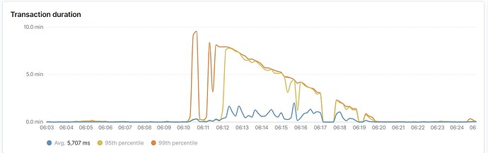

We are using 2.11.5 and we got this issue as well. It doesn’t happen very often.
A timeout occured after 30000ms selecting a server using CompositeServerSelector{ Selectors = MongoDB.Driver.MongoClient+AreSessionsSupportedServerSelector, LatencyLimitingServerSelector{ AllowedLatencyRange = 00:00:00.0150000 } }. Client view of cluster state is { ClusterId : “1”, ConnectionMode : “Automatic”, Type : “Sharded”, State : “Disconnected”, Servers : [{ ServerId: “{ ClusterId : 1, EndPoint : “192.168.225.110:27017” }”, EndPoint: “192.168.225.110:27017”, ReasonChanged: “InvalidatedBecause:ChannelException:MongoDB.Driver.MongoConnectionException: An exception occurred while receiving a message from the server. —> System.IO.IOException: Unable to read data from the transport connection: An existing connection was forcibly closed by the remote host. —> System.Net.Sockets.SocketException: An existing connection was forcibly closed by the remote host
at System.Net.Sockets.Socket.EndReceive(IAsyncResult asyncResult)
at System.Net.Sockets.NetworkStream.EndRead(IAsyncResult asyncResult)
— End of stack trace from previous location where exception was thrown —
at System.Runtime.ExceptionServices.ExceptionDispatchInfo.Throw()
at System.Runtime.CompilerServices.TaskAwaiter.HandleNonSuccessAndDebuggerNotification(Task task)
at MongoDB.Driver.Core.Servers.Server.ServerChannel.d__33`1.MoveNext()”, State: “Disconnected”, ServerVersion: , TopologyVersion: , Type: “Unknown”, LastHeartbeatTimestamp: null, LastUpdateTimestamp: “2021-01-20T16:05:37.3963307Z” }] }.

As far I can tell with multiple dev reviews, we are correctly using the singleton instantiation of the MongoClient and rely on it to manage the connection pools when needed.
When the mongo pool hangs, the API response times spike, then monotonically decrease until the API container that is using the MongoClient is recycled because of connection timeouts.
My next thought is to start playing with localThreshold to increase the window above the default 15ms to make sure that one or more servers are available in extreme events. Is there a way to get the RTT to servers as seen from the mongo driver and dump those in the case of these timeouts to see if they are limiting?
